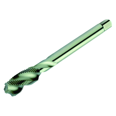

CoroTap® 300, cutting tap with spiral flutes
Being replaced by
T300-XM100DB-M16X150C150
ISO: T300-NM100DB-M16X150B150
Material Id: 7666383
EAN: 7323224171015
ANSI: T300-NM100DB-M16X150B150
Start values
20 m/min
N
Thread size
(TDZ)
MF 16x1.5
Thread form
(THFT)
MF 60°
Tap chamfer length
(TCL)
2.9749 mm
Thread pitch
(TP)
1.5 mm
Thread diameter
(TD)
16 mm
Premachined hole diameter
(PHD)
14.5 mm
Premachined hole type
(PHT)
blind hole
Hole type
(HTY)
blind hole
Thread tolerance class
(TCTR)
6H
Shank standard group
(BSG)
DIN 374
Usable length
58 mm
Tap shank DIN -metric: 12.00 x 9.00
Chip breaker
NM
B150
HSS-E
Coolant exit style
12 mm
Connection diameter tolerance
(TCDCON)
h9
100 mm
Neck diameter
(DN)
11.7 mm
Flute count
(NOF)
3
Flute helix angle
(FHA)
35 °
Radial rake angle
(GAMF)
18 °
Threading length
(THL)
21 mm
Threading chamfer type
(THCHT)
C = 2-3xTP
0.0799 kg
100 mm
