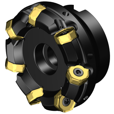

CoroMill® 745 face milling cutter
Specific representation
ISO: A745-102R38-21M
Material Id: 6702265
EAN: 26702265
ANSI: A745-102R38-21M

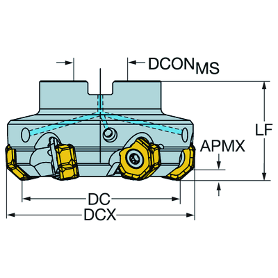

Tool cutting edge angle
(KAPR)
42 °
Cutting diameter
101.6 mm
Maximum cutting diameter
(DCX)
116.8 mm
Cutting item count
(CICT_2)
7
Clamping type code
Part 2 of cutting item interface identifiers
(CUTINT_MASTER_2)
CoroMill 745 -size 2109 (745R-2109)
Depth of cut maximum
(APMX_FFW)
5.2 mm
Maximum ramping angle
Maximum plunge depth
(AZ)
(ZEFP)
7
Arbor -ISO 6462 -A (hexagon socket head cap screw) -inch: 1 1/2
Coolant pressure
10 bar
38.1 mm
Standard number
(STDNO)
ISO6462
Standard letter
(STDLET)
A
63 mm
Radial rake angle
(GAMF)
-29.7308 °
Axial rake angle
(GAMP)
-7.5813 °
12 Nm
Body material
Steel
Rotational speed maximum
4,725 1/min
2.771 kg
63 mm
