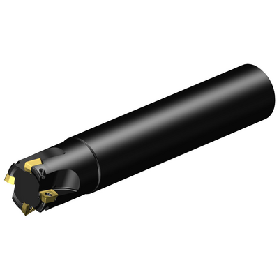

CoroMill® 390 square shoulder milling cutter
Specific representation
ISO: R390-020A20-07M
Material Id: 6851107
EAN: 7323220189861
ANSI: R390-020A20-07M
Tool cutting edge angle
(KAPR)
Cutting diameter
20 mm
Cutting item count
(CICT_1)
Clamping type code
Part 2 of cutting item interface identifiers
(CUTINT_MASTER_1)
CoroMill 390 -size 07 (390R-07)
Depth of cut maximum
5.8 mm
Working engagement ratio maximum
(AERMX)
1
Maximum ramping angle
2.1 °
Maximum plunge depth
(AZ)
0.5 mm
Usable length
25 mm
Cutting pitch differential
(CPDF)
Yes
(ZEFP)
Cylindrical shank without clamping features (without flange) -metric: 20.0
Coolant pressure
10 bar
20 mm
Connection diameter tolerance
(TCDCON)
h6
110 mm
Body diameter
(BD)
19 mm
Body length
(LB)
25 mm
Radial rake angle
(GAMF)
-9.9178 °
Axial rake angle
(GAMP)
10.158 °
0.5 Nm
Body material
Steel
Rotational speed maximum
32,500 1/min
0.257 kg
110 mm
Insert seat - metric
07
07
9/22/15
15.2
