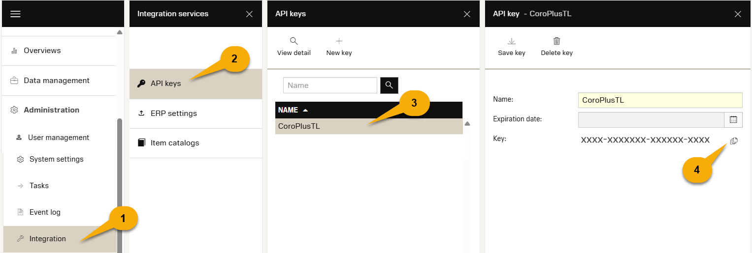

Get an API Authentication Key
To connect CoroPlus® Tool Library with CoroPlus® Tool Supply, you will need an API key. Follow the steps below to obtain it from CoroPlus® Tool Supply.
  1. Go to Integration in the Administration section of the CoroPlus® Tool Supply admin portal.
  2. Select API keys in Integration services.
  3. Select existing keys or create a New key if required.
  4. Copy the key value. You will use this in CoroPlus® Tool Library as described in the next section.
