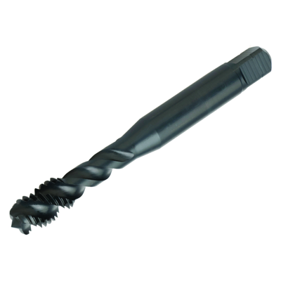

CoroTap® 300, cutting tap with spiral flutes
Being replaced by
T300-MM101AJ-1 C145
Available within a week
Fully exchangeable with the original product.
Out of stock
ISO: E0791-14
Material Id: 6182923
EAN: 26182923
ANSI: E0791-14
Thread size
(TDZ)
UNS 1"-14
Thread form
(THFT)
UN 60°
Tap chamfer length
(TCL)
3.2459 mm
Threads per inch
(TPI)
14
Thread diameter
(TD)
25.4 mm
Premachined hole diameter
(PHD)
23.5 mm
Premachined hole type
(PHT)
blind hole
Hole type
(HTY)
blind hole
Tolerance class tool
(TCT)
H4 = Basic Plus 0.0015" to Plus 0.0020"
Thread tolerance class
(TCTR)
3B
Shank standard group
(BSG)
ANSI
Usable length
65.6 mm
Tap shank ANSI -inch: 0.800 x 0.600
Chip breaker
MM
T3P4
HSS-PM
PVD FeN
Coolant exit style
20.32 mm
Connection diameter tolerance
(TCDCON)
h9
130.2 mm
Neck diameter
(DN)
19.9 mm
Flute count
(NOF)
Flute helix angle
(FHA)
48 °
Radial rake angle
(GAMF)
13 °
Threading length
(THL)
30 mm
Threading chamfer type
(THCHT)
C = 2-3xTP
0.298 kg
130.2 mm
