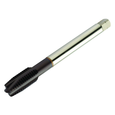

Being replaced by T200-PD101DA-M20 D110
Fully exchangeable with the original product.
ISO: E326M20file_copy
Material Id: 6182506file_copy
EAN: 26182506file_copy
ANSI: E326M20file_copy
PSearch Icon
Thread size(TDZ)info
M 20Search Icon
Thread form(THFT)info
M (Metric 60°)Search Icon
Tap chamfer length(TCL)info
11.1054 mmSearch Icon
Thread pitch(TP)info
2.5 mmSearch Icon
Thread diameter(TD)info
20 mmSearch Icon
Premachined hole diameter(PHD)info
17.5 mmSearch Icon
through holeSearch Icon
Hole type(HTY)info
Thread tolerance class(TCTR)info
6HSearch Icon
Shank standard group(BSG)info
DIN 376Search Icon
Usable length (LU)info
95 mmSearch Icon
Tap shank DIN -metric: 16.00 x 12.00Search Icon
Chip breaker(CBMD)info
PMSearch Icon
Grade (GRADE)info
T4J8Search Icon
Substrate(SUBSTRATE)info
HSS-E-PMSearch Icon
Coating(COATING)info
PVD TiAlNSearch Icon
Coolant entry style(CNSC)info
Coolant exit style(CXSC)info
no coolant exitSearch Icon
Connection diameter machine side(DCONMS)info
16 mmSearch Icon
Connection diameter tolerance(TCDCON)info
h9Search Icon
Functional length(LF)info
140 mmSearch Icon
Neck diameter(DN)info
15.7 mmSearch Icon
Flute count(NOF)info
4Search Icon
Flute helix angle(FHA)info
Radial rake angle(GAMF)info
5 °Search Icon
Threading length(THL)info
30 mmSearch Icon
Threading chamfer type(THCHT)info
B = 3.5-5xTP GunnoseSearch Icon
Weight of item(WT)info
0.214 kgSearch Icon
Overall length(OAL)info
140 mmSearch Icon
