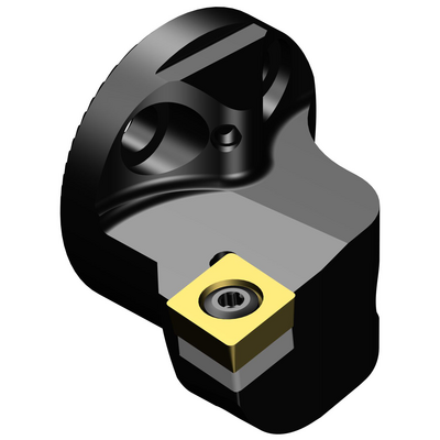

CoroTurn® 107, cutting head for turning
Specific representation
ISO: 570-SCLCL-40-12
Material Id: 5962601
EAN: 25962601
ANSI: 570-SCLCL-40-12
Tool cutting edge angle
95 °
Lead angle
-5 °
Clamping type code
Insert type
CCMT 120408
Maximum ramping angle
Minimum bore diameter
50 mm
Workpiece side body angle
Machine side body angle
Maximum overhang
38 mm
Coolant exit style
Coolant pressure
40 bar
40 mm
38 mm
Functional width
27 mm
Functional height
Orthogonal rake angle
Inclination angle
-7 °
3 Nm
Body material
Steel
0.227 kg
Master insert identification
CCMT 12 04 08
41.8 mm
Insert seat - metric
12
2/16/11
11.1
