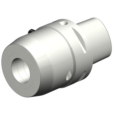

930-C8-HD-A31-085
930-C8-HD-A31-085
930-C8-HD-A31-085
Coromant Capto® to CoroChuck® 930
Specific representation
ISO: 930-C8-HD-A31-085
Material Id: 7105366
EAN: 7323221300685
ANSI: 930-C8-HD-A31-085
Connection - workpiece side
(ADINTWS)
Hydraulic Membrane chuck -inch: 1 1/4 (excluding WE/WN shanks)
Coolant exit style
axial concentric exit
Coolant pressure
80 bar
80 mm
Functional diameter
(DFC)
55 mm
Standard number
(STDNO)
ISO26623-1
Connection diameter workpiece side
(DCONWS)
31.75 mm
Kappa (z-axis rot)
(KAP)
85 mm
Body diameter
(BD_1)
67.8 mm
Body diameter
(BD_2)
76 mm
Body diameter
(BD_3)
80 mm
Body length
(LB_1)
18.8 mm
Body length
(LB_2)
53.3 mm
Body length
(LB_3)
85 mm
Body half taper angle
(BHTA_1)
12 °
(BHTA_2)
(BHTA_3)
10 Nm
Rotational speed maximum
14,000 1/min
Body material
Steel
Balancing method code
(BLMC)
Balancing by design
3.344 kg
133 mm
9/22/16
