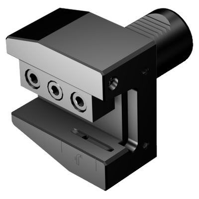

ASHA-L-VDI50-25-HP
ASHA-L-VDI50-25-HP
ASHA-L-VDI50-25-HP
VDI to rectangular shank adaptor
Made-to-order
ISO: ASHA-L-VDI50-25-HP
Material Id: 6472358
EAN: 26472358
ANSI: ASHA-L-VDI50-25-HP

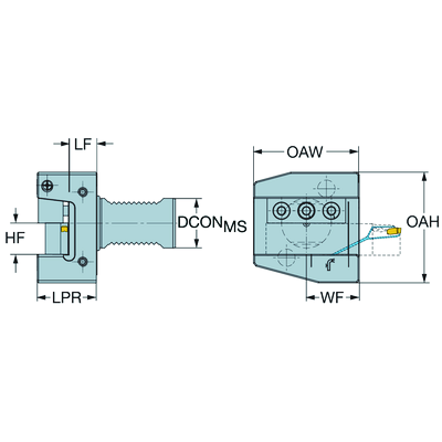

VDI machine interface -size 50
Connection - workpiece side
(ADINTWS)
Maximum overhang
23 mm
decentral over flange
Coolant exit style
Coolant pressure
80 bar
50 mm
Protruding length
(LPR)
48 mm
(LF_1)
23 mm
Functional width
(WF_1)
50 mm
Functional height
(HF_1)
25 mm
123 mm
Overall height
(OAH)
110 mm
Overall width
(OAW)
100 mm
25 Nm
Body material
Steel
4.421 kg
