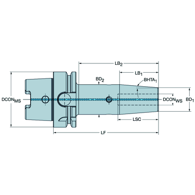

HSK -A -size 100
Connection - workpiece side
(ADINTWS)
Cylindrical clamping (shrink fit) -metric: 8
Coolant exit style
axial concentric exit
Coolant pressure
10 bar
Data chip pocket
(DCP)
Yes
Data chip pocket size
(DCPS)
Dia.=10 mm/Height=4,5 mm
100 mm
Functional diameter
(DFC)
75.013 mm
Standard number
(STDNO)
ISO12164-1
Standard letter
(STDLET)
A
Connection diameter workpiece side
(DCONWS)
8 mm
Kappa (z-axis rot)
(KAP)
85 mm
Body diameter
(BD_1)
21 mm
Body diameter
(BD_2)
27 mm
Body diameter
(BD_3)
100 mm
Body length
(LB_1)
38.14 mm
Body length
(LB_2)
56 mm
Body length
(LB_3)
85 mm
Body half taper angle
(BHTA_1)
4.5 °
(BHTA_2)
(BHTA_3)
Rotational speed maximum
12,500 1/min
Body material
Steel
Balancing method code
(BLMC)
Balancing by design
2.182 kg
135 mm
