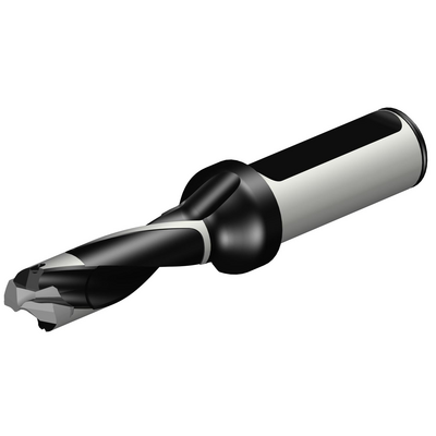

CoroDrill® 870 exchangeable tip drill
Specific representation
ISO: 870-1500-15LX075-3
Material Id: 6035686
EAN: 26035686
ANSI: 870-1500-15LX075-3
Minimum cutting diameter
(DCN)
15 mm
Maximum cutting diameter
(DCX)
15.99 mm
Clamping type code
Insert type
CoroDrill 870-1590-15-PM
Cutting item count
(CICT)
1
0.9 Nm
Achievable hole tolerance
(TCHA)
H9
Usable length
50.42 mm
Usable length diameter ratio
(ULDR)
3.1711
Face effective cutt edge count
(ZEFF)
Cylindrical shank (ISO9766 drill shank with flange) -inch: 3/4
Coolant pressure
10 bar
19.05 mm
Point length
(PL)
2.44 mm
119 mm
66.56 mm
Body length
(LB)
53 mm
Rotational speed maximum
33,000 1/min
0.178 kg
Insert seat - metric
15
15
2/25/12
12.1
