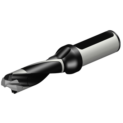

CoroDrill® 870 exchangeable tip drill
Specific representation
ISO: 870-1800-18L20-3
Material Id: 6035729
EAN: 26035729
ANSI: 870-1800-18L20-3
Minimum cutting diameter
(DCN)
18 mm
Maximum cutting diameter
(DCX)
18.99 mm
Clamping type code
Insert type
CoroDrill 870-1890-18-PM
Cutting item count
(CICT)
1
1.2 Nm
Achievable hole tolerance
(TCHA)
H9
Usable length
59.86 mm
Usable length diameter ratio
(ULDR)
3.1672
Face effective cutt edge count
(ZEFF)
Cylindrical shank (ISO9766 drill shank with flange) -metric: 20
Coolant pressure
10 bar
20 mm
Point length
(PL)
2.87 mm
129 mm
76.13 mm
Body length
(LB)
62 mm
Rotational speed maximum
30,000 1/min
0.238 kg
Insert seat - metric
18
18
2/25/12
12.1
